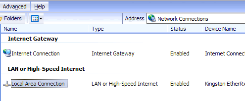

  2. Once you've done the previous step... In Windows, click start>settings>control panel>network connections to open this page:
    Compare what you see to my picture, if you have the entry that says Internet Gateway enabled, you already have UPnP installed and this whole process will be easier. Windows XP should have already set all this up if you bought your router and it already had firmware version 1.42 (?) or later installed. If you do anyway then skip ahead to step number 4 below.

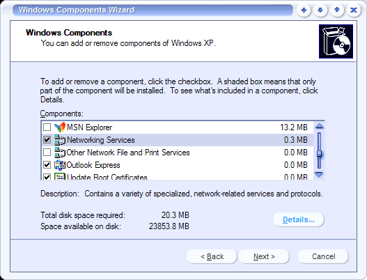

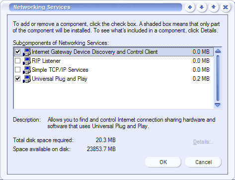

    3. In the Windows Components Wizard, click Networking Services, click Details, and then select the 'Universal Plug and Play' check box. You should also see 'Internet Gateway Device Discovery and Control Client' listed, put a tick in the check box for this also - as I've done below.
    4. Click OK, and then click Next in the Windows Components Wizard. You may need to provide your Windows XP installation CD.

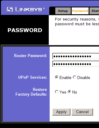

    1. Using your browser, go to http://192.168.1.1/Passwd.htm and, as shown in the picture below, make sure that 'UPnP Services' are enabled:

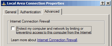

    1. Click Start>Settings>Network Connections. Right click on 'Local Area Connection'. Select 'Properties'. A small window appears. At the top click on 'Advanced'. Make sure that the XP firewall is turned off as in the picture below:

    The first thing to do is to highlight the entry for the local area connection in the network connections page just like i'm doing in the picture below:
    On the left side in the details section you should now see your router assigned ip address as shown in the picture below:
     ...in this example it is 192.168.1.100, make a mental note of whatever yours happens to be.

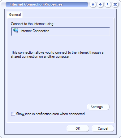

  5. Back on the main section of the page, right click on 'Internet Connection' and then select 'Properties' from the menu that appears.
    You'll see this window:

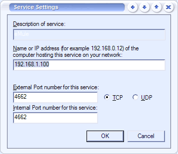

    Click on settings, and then 'Add'. This is where you will specify which ports the router needs to forward to make eMule work. Fill in the blanks as below, except in the IP address field substitute your own router assigned IP address that you memorized from the previous step. The 'Description of Service' text field can be anything you like - it's just so you can identify it later... "eMule" works just fine:

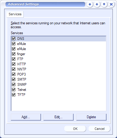

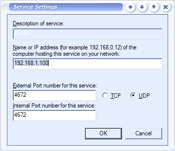

  6. After clicking on 'OK' to save this new setting, click 'Add' once again to setup a second port forward. Once again fill in your own IP address, type "eMule" as the description of service, and copy the remaining details as they are shown below. Then click 'Ok' to save the settings:
  7. You'll notice that you now have two entries for eMule, as in the picture below:
    Click 'Ok' to save the settings you made and exit. That's pretty much all there is to it! You've told your router to forward incoming traffic to ports 4662 and 4672 on your computer. Run emule and everything should now work.

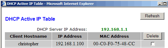

    Then click on the button labelled 'DHCP Clients Table'. You'll see the window below appear:
    Look in the Client Hostname column, find your computer name and memorize the last three numbers of the IP address to the right of it. In this example the client hostname is 'Christopher', and the last three numbers of the IP address are 100. Once you've got those three numbers memorized then close the window.

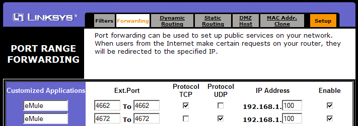

  3. At the top of the screen, on the right hand side, click on the orange colored tab labelled 'Advanced'. You'll arrive on the 'filters' page - you don't want to do anything here, instead click on the second tab along labelled 'Forwarding'... and fill out the details as I have below. Except of course you need to fill out the last three numbers of your IP address that you memorized (it might well be 100 like mine is):
  4. At the bottom click on 'Apply' to save the settings you just typed in. Now your router is setup to forward incoming traffic to ports 4662, and 4672 on your computer. Close out the browser window, and run eMule, it should now work!

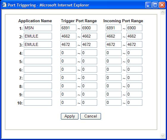

  1. Open up your internet browser and type the IP Address of your router (default: 192.168.1.1). Enter in your password (default: admin - change it!). Click 'Advanced'. Click 'Forwarding'.
  2. In the Forwarding screen you will find the button Port Triggering. Click it and enter the configuration shown below. You can ignore the msn entry when configuring eMule.
  3. Press 'Apply'.This should now allow your router to forward eMule packets to your machine without the need for specific IP Addresses allowing for DHCP or multiple machines using eMule.
